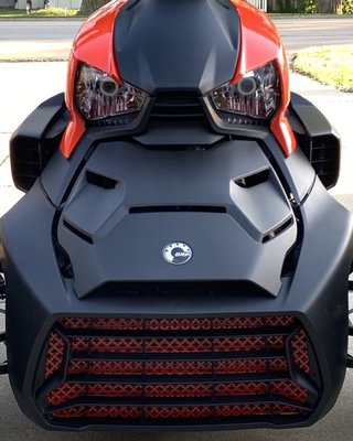

Radiator grill install and painted

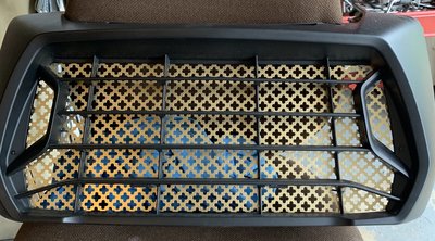

Radiator grill before painted
At least now I have a piece of mind knowing that the radiator is protected.

Nice! How much for the Adrenaline Red one?

What is it made out of? And how is it installed?
Re: Homemade radiator grill
Posted: Wed Sep 18, 2019 3:28 pm
by Rykerrider39
Aluminum with 2 machine screws one on each side,some zip ties in the middle.

Good time for home projects. Home Depot over by the screen doors sells this stuff precut to 24"x18" for $10.59. You will need a cutoff saw and wire brush to clean edges. Make cardboard pattern, trace on metal and cut off edges. Roll edges/ Prime/ Paint. Seems like alot of work but really not. With my normal household tools removing the prime and painting it was a three hour project to make two of them for my wife's and my Rykers. Still trying to figure out how to post pics, sorry

You will need a cut off saw for cutting metal. There has been a comment that you need a new cutting wheel for each one you cut, i could cut 20 out with one wheel.
That stuff will not cut with tin snips and a hack saw will make a mess.
